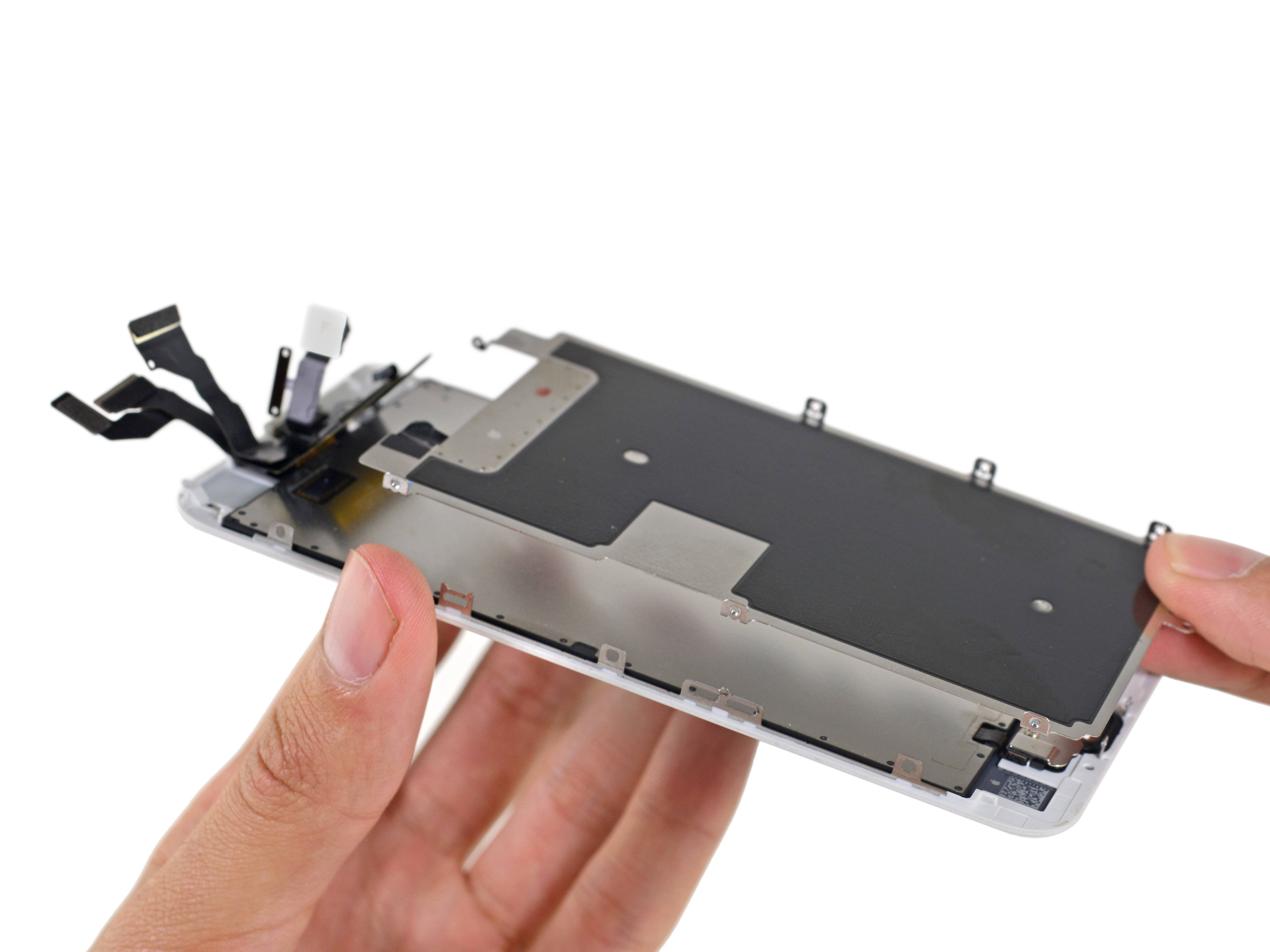

Step 8
  • In order to take out the shield plate we first have to remove a bracket, speaker, and the FaceTime camera.
  • While the FaceTime camera has jumped from 1.2 MP all the way up to 5 MP, its overall form factor remains surprisingly similar.
  • We have to take a moment to calm down as we get closer to unearthing the secrets of the new 3D Touch display assembly.

  • With the LCD shield plate removed, we get our first glance at what we believe is the 3D Touch IC:
    343S00014 (Naming scheme is very similar to other Apple ICs, but the jury is still out on the manufacturer)

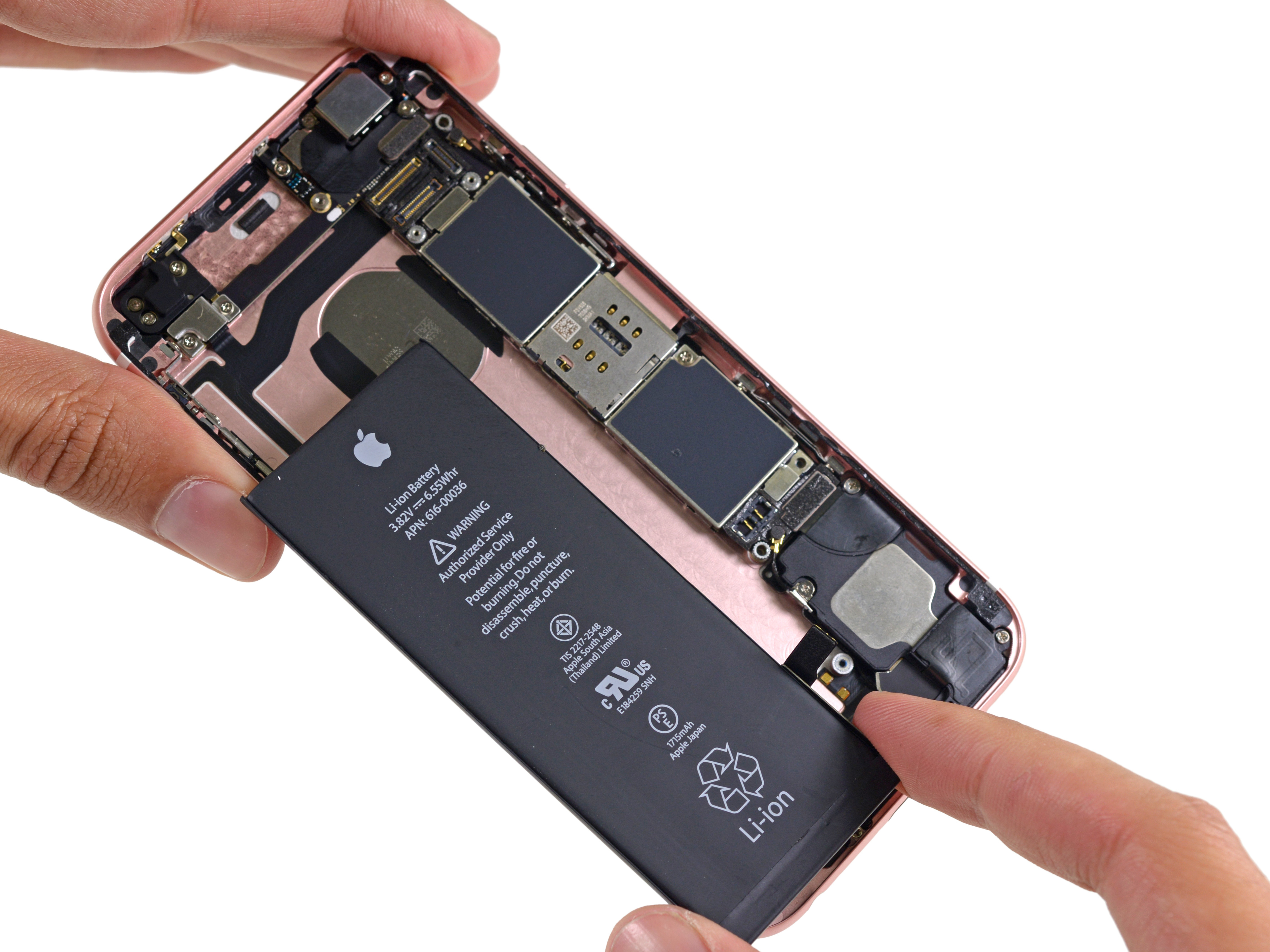

  • We breathe a sigh of relief every time we see those nice battery adhesive pull tabs. Hopefully they never go extinct.
  • A quick pull and the battery pops right out for inspection!
yt1Cdibylqq36IJ1
ZVK5tGoUjQRyfwQp
Step 13
  • It turns out the rumors were true—battery capacity is down a bit, likely in order to make room for new features like the Taptic Engine and slightly thicker display.
  • The Lithium-ion pack comes in at 3.8 V, 6.55 Whr, and 1715 mAh. It's a small but notable decrease from the 1810 mAh battery in last year's iPhone 6.
  • This iPhone's battery still has the same identity issues as last year's. It seems to think it's from Apple South Asia (Thailand) Limited, Apple Japan, and is made in Changsu, China.
  • Nevertheless, Apple says battery life holds steady at up to 14 hours of 3G talk time and 10 days of standby—the same as in the iPhone 6. A lot of this is likely due to more efficient silicon, which we're eager to get a look at...

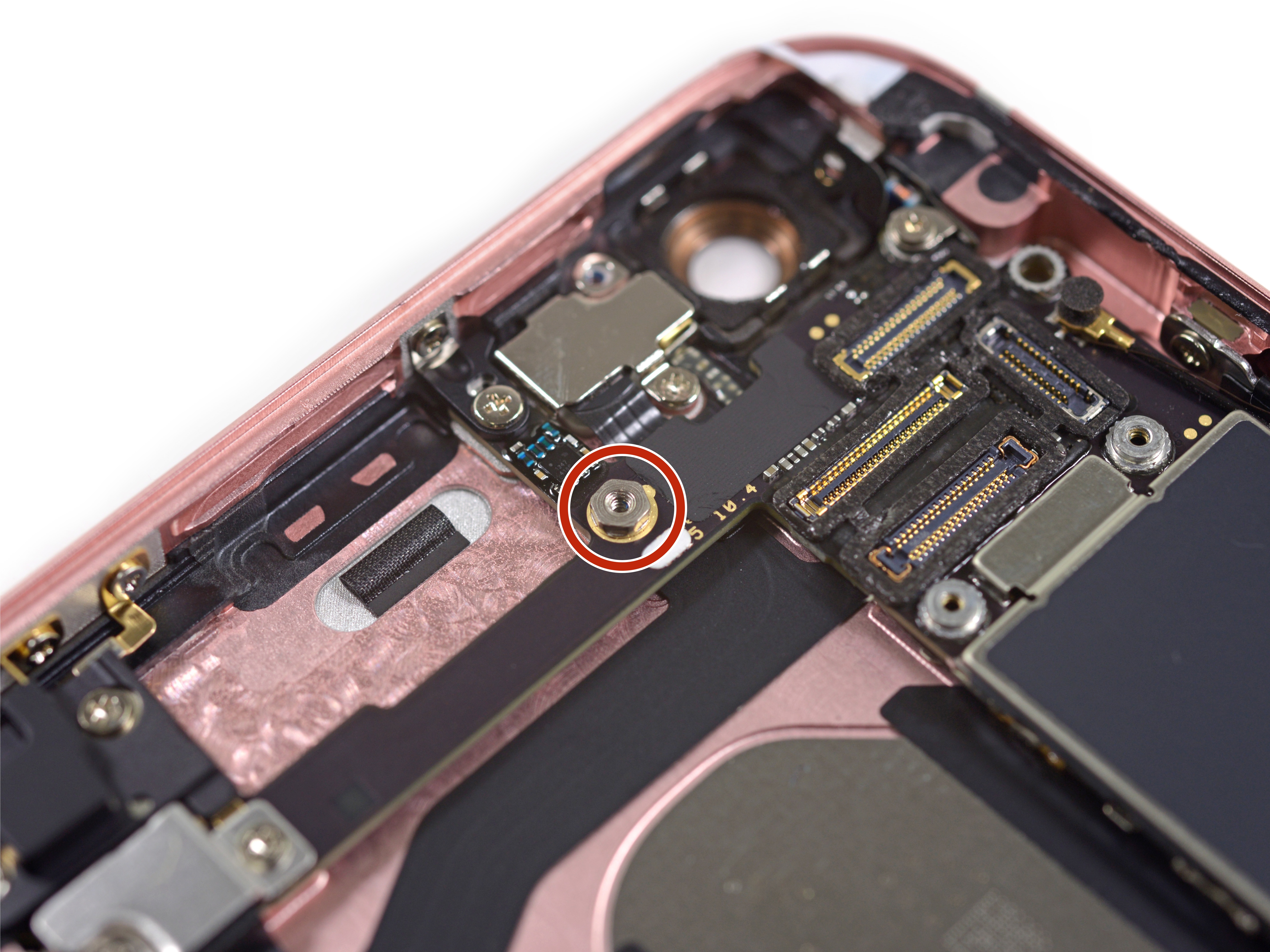

  • We find a strange hex head in the place of the more standard stand-off screw, add a new tool to your smartphone arsenal...
  • And out comes the Lovecraftian antenna unit seen in previous models.
