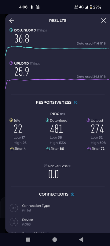

I went around my area today and found out that Single eNB FDD-TDD sites have 64/256QAM UL working while the sites with FDD and TDD and diff eNB have 16QAM UL on FDD and 64/256QAM on TDD
Mine also dual eNB, seems if 64QAM enabled means we can get around 50mbps UL for 20Mhz B3
